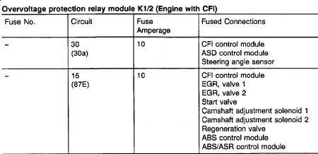

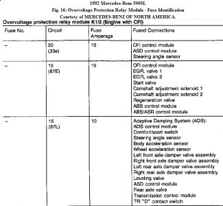

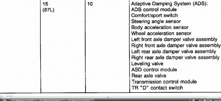

i just put a heater core in and all works ok but the abs and asr light is on. i found a blown 10 amp fuse on the overvoltage relay and replaced. fuse blown instant. i have alldata and it only shows the abs and cis module on this circuit. i have unplugged both and it blows fuse. i have worked on cars for years but this one has kicked my butt. thanks for your help
