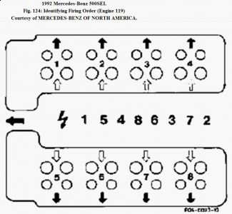

1992 Mercedes Benz 500sel V8 Two Wheel Drive 170000 miles

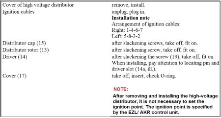

just put plugs back in can't remember the placement could you give me the distributor firing order for this motor you know what i want
Mar 12, 2010 at 11:45 AM
MERLIN2021
  • 17,250 POSTS
This should do it for you.
https://images.2carpros.com/forum/automotive_pictures/62217_FOa_1.jpg
https://images.2carpros.com/forum/automotive_pictures/62217_V8_1.jpg
