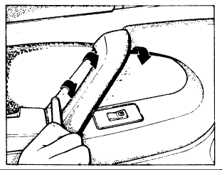

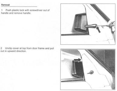

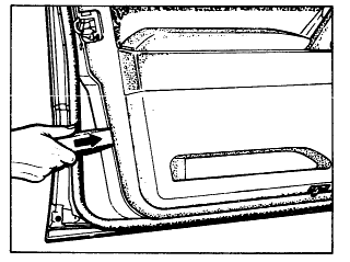

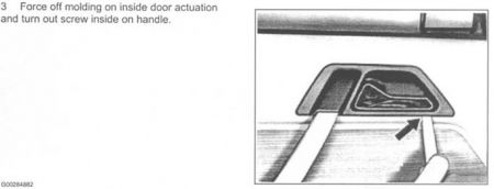

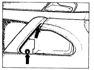

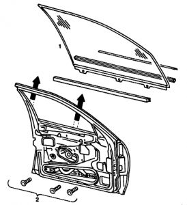

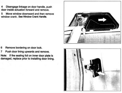

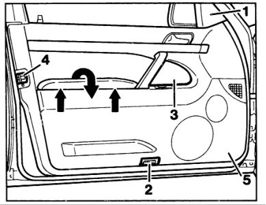

how is it done havewindow that will not go up

Preliminary work : Door liner removed. See: Body and Frame\Doors, Hood and Trunk\Front Door Panel\Service and Repair\Removal and Replacement Conversion Calculator 1995 Mercedes Benz S 420 (140.043) V8-4.2L (119.971) Vehicle Level Body and Frame Doors, Hood and Trunk Front Door Panel Service and Repair Removal and Replacement Sedan Sedan Removal and installation of door liner on driver's door
https://images.2carpros.com/forum/automotive_pictures/12900_dl1_2.jpg
Special tools Removal, Installation
https://images.2carpros.com/forum/automotive_pictures/12900_dl2_1.gif

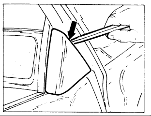

Press off cover toward inside with wedge 115 589 03 59 00 and remove upward. Remove filler piece below cover. Remove entry light.
https://images.2carpros.com/forum/automotive_pictures/12900_dl3_1.gif

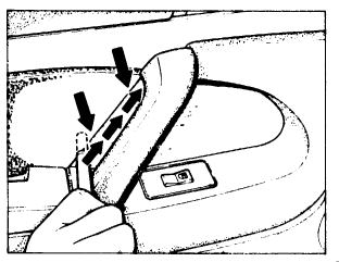

Unhook wooden cover at rear using special tool 140 589 16 63 00 by inserting blade of special tool between wooden cover and upholstery on door panelling, then pull special tool all the way up (arrows). At the same time the two rotating bars are turned back (refer to item 6, arrows).
https://images.2carpros.com/forum/automotive_pictures/12900_dl4_1.gif
Tip wooden cover toward inside at top and bottom using special tool.
https://images.2carpros.com/forum/automotive_pictures/12900_dl5_1.gif
Wooden cover-rear Remove wooden cover toward front.
https://images.2carpros.com/forum/automotive_pictures/12900_dl6_1.gif
https://images.2carpros.com/forum/automotive_pictures/12900_dl7_1.gif

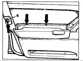

Unscrew the screws in area of door handle (arrows). Open cover above door pocket.
https://images.2carpros.com/forum/automotive_pictures/12900_dl8_1.gif

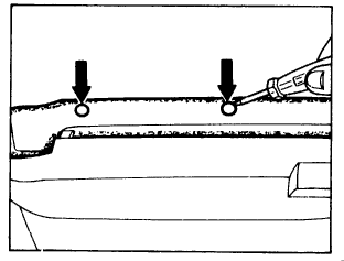

Remove plugs (arrows) using awl. Puncture plugs at outer edge only and pull out.
https://images.2carpros.com/forum/automotive_pictures/12900_dl9_1.gif
Screw out the screws in area of door pocket (arrows), screw off door cover plate (4) and remove.
https://images.2carpros.com/forum/automotive_pictures/12900_dl10_1.gif

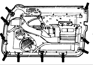

Press door liner off of interior door panel at bottom, front and rear using plastic wedge 110 589 03 59 00 (10 clips); insert plastic wedge directly at clip. Beginning at front top, remove door liner from channel whilst simultaneously pulling door liner away from interior door panel at bottom.
https://images.2carpros.com/forum/automotive_pictures/12900_dl11_1.gif

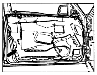

Preliminary work : Door liner removed. See: Body and Frame\Doors, Hood and Trunk\Front Door Panel\Service and Repair\Removal and Replacement Exterior mirror removed. Exterior molding with sealing bar on belt line removed. Crank window (1) open until screws (2) on window lift bar are accessible through installation opening at bottom. Screws (2) on window lift bar screw out (3 each), use Torx wrench attachment T30. Crank window (1) remove upward out of door shaft while tipping window toward front. Crank window (1) insert into door shaft from outside while tipping window toward front, guide into window guide channels at front and rear and insert into mounting hooks on window lift bar. Screw (2) on window lift bar, screw in and tighten hand-tight. Sealing channels and molding on door shaft install. Crank window (1) close. Crank window adjustment check, readjust if required. Screw (2) tighten. Exterior mirror install. Form piece glue onto interior door panel. Door liner install. Exterior mirror removed. Exterior molding with sealing bar on belt line removed.
https://images.2carpros.com/forum/automotive_pictures/12900_d1_12.jpg
