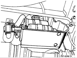

dont know how to replace fuel filter
Jan 9, 2010 at 3:02 PM
  • 75,988 POSTS
REPLACING FUEL FILTER
https://images.2carpros.com/forum/automotive_pictures/12900_fuelfilterbenz1_2.gif
*Remove protective cover. *Disconnect fuel lines.

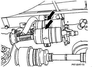

*Loosen mounting screws (arrows) and remove filter. *Unscrew fitting from old filter and attach to new filter with new seal ring. *Install new fuel filter in flow direction with plastic sleeve. *Sleeve should project on both sides of the holder since contact corrosion may occur if there is direct contact with the holder. *Replace plastic sleeve, if necessary. *Connect steel line to filter. *Retighten mounting screws. *Check for leaks.
