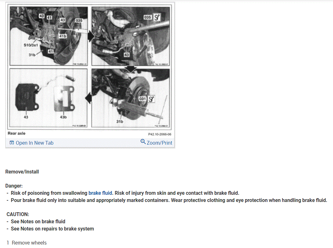

I need to do rear brakes on my car
2004 MERCEDES BENZ 350SDL
IAMDEANDAMMIT
I need to do rear brakes on my car?

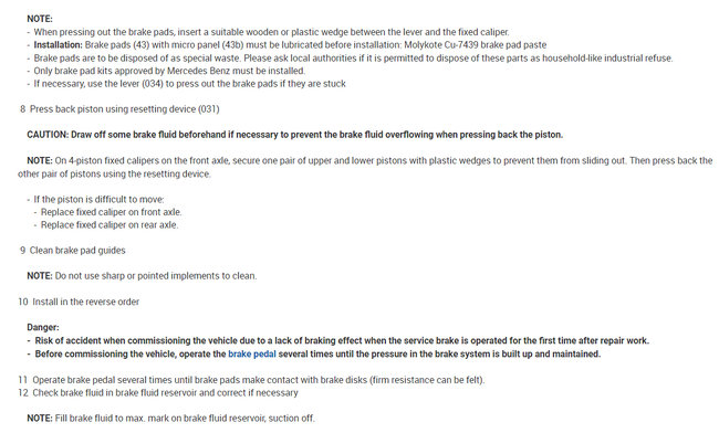

Replacing the rear brake pads really isn't too difficult. In most cases, you can expect rear pads to last approx 30,000 miles. However, that can change based on driving habits and terrain.
To get you started, here is a link that shows in general how it is done. You can use this to help guide you.
https://www.2carpros.com/articles/how-to-replace-rear-brake-pads-and-rotors

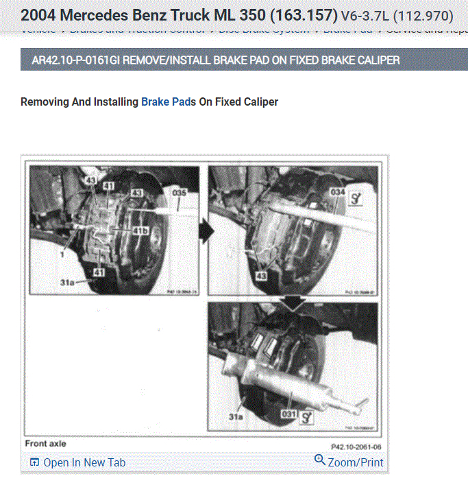

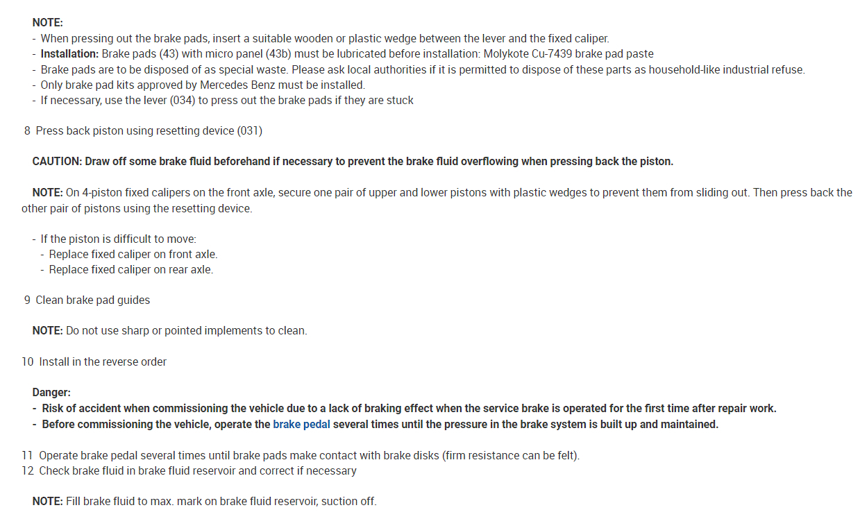

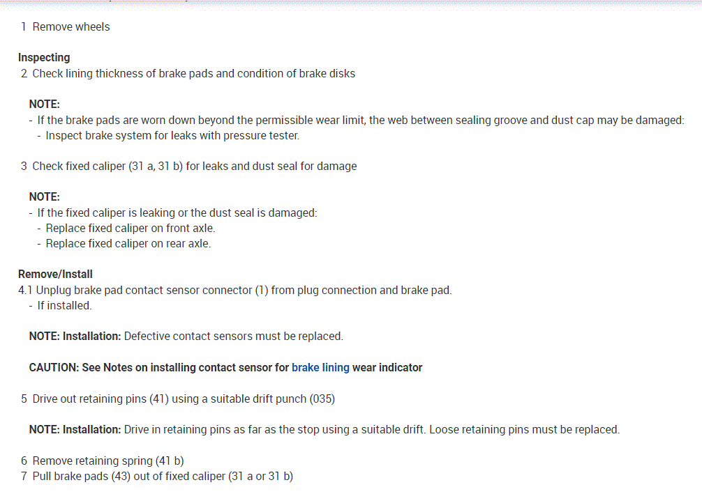

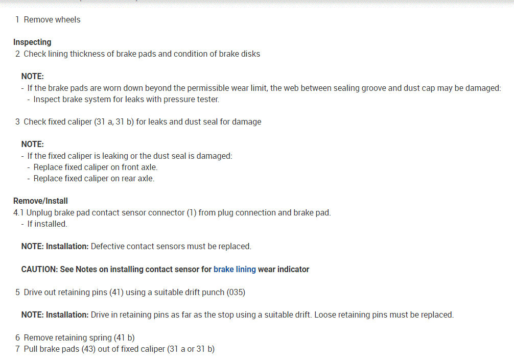

If you look at the attachments below, I included the directions and pics specific to your vehicle for replacement.

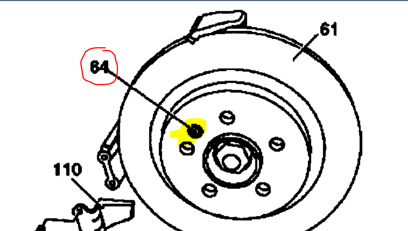

Once the brake caliper has been removed and the pads, you will need to remove the caliper mount so the rotor can be removed. There are two bolts on the rear of the hub assembly. Remove the bolts, remove the mount, then remove and replace the brake rotor. Note there is a retaining screw that will need to be removed. See the last pic below. I highlighted the screw I am referring to.
