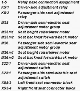

One day while driving the passenger seat started moving by itself, all the way in the forward position
towards the dashboeard and all other adjustments ( head rest back etc) moved to down to or forward to the max positions.
I tried to reset the memory but when I press the reset the seat goes all the way back to the max until I let up on the reset button (the green button).
When I try the individual buttons to adjust the seat they work until I let off the button, then the seat automatically reverts back to the extreme forward position again. I cannot reset or postion the seat with memory.
Thank You
Sep 2, 2009 at 9:04 PM
MERLIN2021
  • 17,250 POSTS

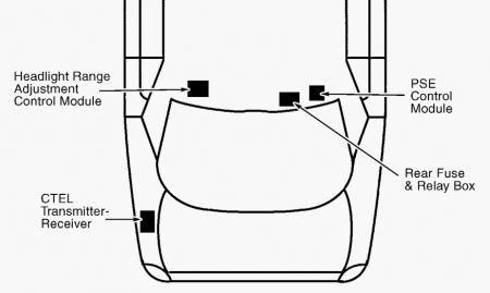

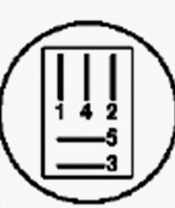

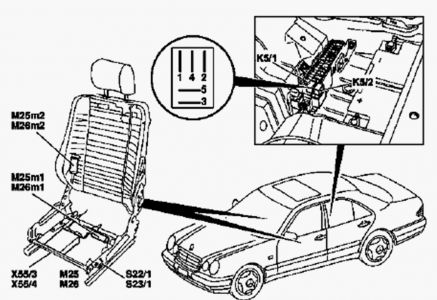

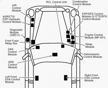

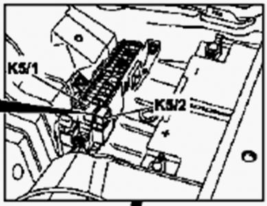

Could be a stuck relay for the seat, or the door module which stores the memeory feature and controls operation, but scanning for codes is needed!
