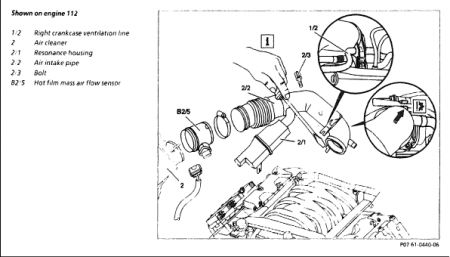

How do you replace a mass airflow sensor?
I got a code P0335
Aug 13, 2010 at 1:50 PM
  • 75,992 POSTS
Service and Repair Removing, Installing Hot Film Mass Air Flow Sensor With Air Intake Pipe Shown On Engine 112
https://images.2carpros.com/forum/automotive_pictures/12900_m_2.jpg
CAUTION: Cable of electronic accelerator actuator *Removal: Detach cable (arrow) before taking Out the air intake pipe (2/2) NOTE: Lock of air intake pipe (2/2) at electronic accelerator actuator *Removal: Use a screwdriver 40 press catch down NOTE: Right crankcase ventilation hue (1/2) *Installation: Fit on from below 2 Air cleaner 2/1 Resonance housing *pull up and out of the rubber mount 2/2 Air intake pipe *Bolt (2/3) B2/5 Hot film mass air flow sensor *separate electrical connection *Slacken hose clamp https://www.2carpros.com/kpages/auto_repair_manuals_alldata.htm "P0335 Crankshaft Position Sensor"
