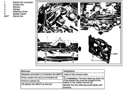

How do you remove the cooling fan

https://images.2carpros.com/forum/automotive_pictures/261618_Noname_2524.jpg
