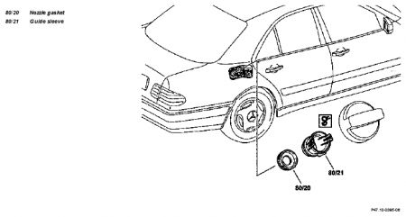

Hello - Okay - most of the things on the MB need special tools to repair. So you will have to look at is really good to see if one of your tools can work or if you have to purchase one. Also, I would check with the dealer to see the cost......just for an estimate. You may have enough. Here is the info on the replacement...........hope that helps........... MAINTENANCE CHECKING THE NOZZLE GASKET IN THE TANK FILLER NECK FOR DAMAGE AND REPLACING IT - AP47.10-P-4751A MODEL 129, 170, 210, 220 with CODE (491) U.S. version Model 210 illustrated Fig. 88: Identifying Nozzle Gasket And Guide Sleeve (Model 210)
https://images.2carpros.com/forum/automotive_pictures/248015_88_1.jpg
Remove/Install Risk of explosion caused by ignition of flammable products, risk of poisoning caused by inhaling fuel vapors or swallowing fuel as well as risk of injury to skin and eyes exposed to fuel. No fire, sparks, open flames or smoking. Pour fuels only into suitable and appropriately marked containers. Wear protective clothing when handling fuel. Replace the nozzle gasket (80/20) If the lip of the nozzle (80/20)is damaged. Release the guide sleeve (80/21) using pliers and take it out. Guide sleeve (80/21) with index (4) in model 129, 170, 210 up to September 98 Guide sleeve (80/21) with index (5) in model 220 Sept. to December 98 and in model 129, 170, 210 Oct. to December 98 Guide sleeve (80/21) with index (6) in model 129, 170, 210 and 220 as of January 99 Guide sleeve modified Model 129, 170, 210 Install in the reverse order

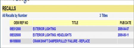

Hello - Also, it looks like you may have some recalls on your vehicle. The dealer may fix these for free. Please contact the dealer service department, give them the VIN number of your car and have them check on these to see if they apply to you.
https://images.2carpros.com/forum/automotive_pictures/248015_recall_6.jpg
Also, I fogot to put a pic of the special tool pliers they were using.
https://images.2carpros.com/forum/automotive_pictures/248015_89_1.png

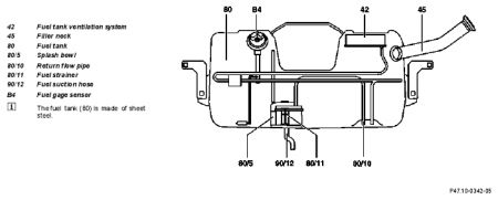

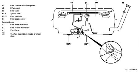

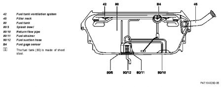

Thanks for replying so quickly. Is it likely that the nozzle gasket and guide sleeve are the only problem? I can't find a picture of the tank anywhere on the web. Do you have a diagram of the whole tank? I'm trying to figure out if the filler tube is likely damaged too. Any feedback?
Dec 20, 2009 at 2:37 PM
IMPALASS
  • 3,112 POSTS
Hello - This is the best we have on the tank. Not sure which model you have, 210/220 or 210.2 or the 210.0 so I gave you all three. 210/220

210.2
https://images.2carpros.com/forum/automotive_pictures/248015_2_125.jpg
210.0
https://images.2carpros.com/forum/automotive_pictures/248015_3_89.jpg
