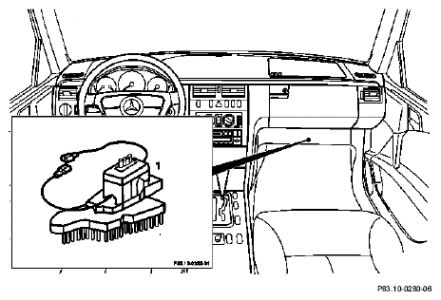

can you tell me where the location of the resistor is l took the blower motor down but did not see where the resistor was .

your vehicle uses a blower regulator , not resistor, it is located below the glove compartment and screwed onto the blower.
