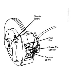

how to replace front brake pads?

Use the old pad to compress the piston, leaver back with a large lever slowly, leave second pad in so piston will not pop and do one side at a time. mark (mhpautos)
