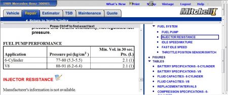

Fuel pressure 3.5bar is about 50psi See specifications
https://images.2carpros.com/forum/automotive_pictures/12900_fuel_pressure_5.jpg

If I can remember back the Bosch K type is a mechanical continuous injection system CIS
Your fuel pressure should be 77-80 psi, what is the fuel pressure now?
Also check the cold start injector spray pattern
This injectiion system has fuel accumulator/mixture control unit you might want to check this components out. I don't have a schematic diagram on this type of injection in the Mit1 auto references. I'm very sorry this is as far as I can take you
