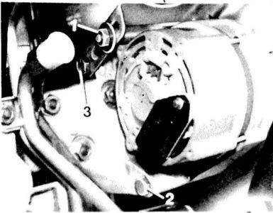

how do you get the belt loose is there a secret bolt? i put a new alternator on it and cant get the pump belt loose to replace the alternator belts it loose but there seems to be something holding it i found 3 bolts to loosten the pump am i missimg 1 ?

Hello - I believe this what you are talking about. Tensioning V-belt A Alternator - coolant pump
https://images.2carpros.com/forum/automotive_pictures/248015_1_124.jpg
1. Loosen nut (1) and screws (2 and 3).

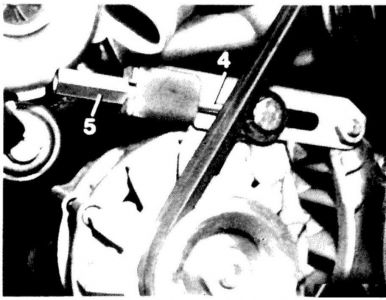

https://images.2carpros.com/forum/automotive_pictures/248015_2_81.jpg
2 Tension V-belt by means of nut (5) of tensioning screw (4). 3 Tighten nut (1) and screws (2 and 3). 4 Continue turning nut (5) by approx. 1/4 to 1/2 turn (to tight seat).
