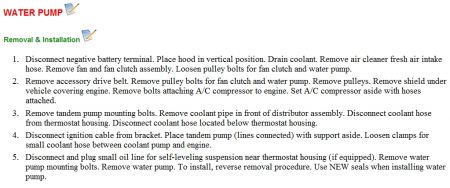

I have to replace the water pump in my 1992 Mercedes 300E. I need a step by step procedure and any diagrams if available. Thanks

Hello and thanks for donating
https://images.2carpros.com/forum/automotive_pictures/261618_Noname_2703.jpg
