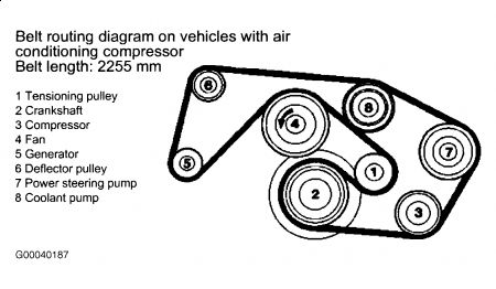

I NEED INSTRUCTION HOW TO PUT THE SERPENTINE BELT ON

I can get you your routing but I need to know what engine model do you have as they are showing like 5 or more engine models. IE- engine model number 102 or 103 or 104 etc. Here is the routing for engine model 103 I think this is the right on. Check your engine model with the plate that is under the hood.
https://images.2carpros.com/forum/automotive_pictures/249564_Graphic_157.jpg
