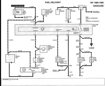

My MB, which has been very reliable, has had the Engine check light come on, and will stay on after I turn the engine off, which has drained the battery. I only use the car on the weekends, as I am in my rig during the week. A Mechanic determined the light is coming on because of Code 7, which he will not tell me is because of(?), I'm sure he wants a large ransom(?) Not. I have figured it is a Rich/lean problem, which may be as simple as a Tune-up, to the Injectors (Ouch!), both of which are a DIY My MB has over 230,000 miles, so I would figure any major repair would be pointless at this stage. Though I do want to say, that this is the first trouble I have had with my Baby. I would like to keep her! Can someone tell me how I can turn off the light so it will not come on after turning off the Engine? Thanks![img:ced626a7b0]http://www.2carpros.com/forum/automotive_pictures/500570_005_1.jpg[/img:ced626a7b0]

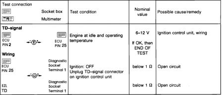

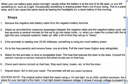

Hi tpasenelli, Welcome to 2carpros and TY for the donation This is gonna be a tough one over the net Impulse Display code 7 unplug the fuel pump relay and see what happen the light continues to come unplug ignition control module and all oxygen sensors-Let me know Code 7
https://images.2carpros.com/forum/automotive_pictures/12900_mercbenz88_1.jpg
https://images.2carpros.com/forum/automotive_pictures/12900_mercbenz88_fuel_pump_relay_1.jpg
https://images.2carpros.com/forum/automotive_pictures/12900_parastic_draw_1_199.jpg
