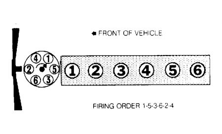

i need the timing marks and firing order

Hi there, Ignition timing is set at 7-11 Deg BTDC @ idle.
https://images.2carpros.com/forum/automotive_pictures/61395_benz_2.jpg
