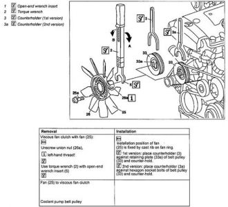

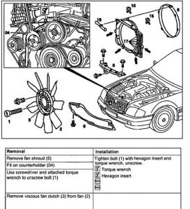

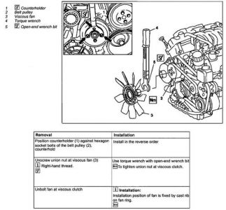

hey guys.. i am huge fan of your webite. Its very informative and full of information. So I felt like you guys could probally help with my problem...Ok, i have a 97 mecedes E300D and I am trying to change out the water pump. the only problem I have is this god forsakken fan clutch...how do you get it off? I mean is there a special tool for it? if so what would I be. I went to the autozone to rent a fan clutch wrench but i really didnt know what to do with it and honsetly it didnt seem to fit on anything in regards to the fan clutch..if there is a tool how do yu use it. what does it attach to where do you fet it from...heck can it be removed please help..a
Dec 6, 2009 at 4:48 AM
BLUELIGHTNIN6
  • 16,542 POSTS
Hello and thanks for the donation and compliment! Below are the 3 types of fan clutches that were used in the 1997 300 series motors. You should be able to match up the picture with your motor then follow its replacement steps to learn how to remove and replace your viscous fan clutch.
https://images.2carpros.com/forum/automotive_pictures/261618_Noname_1239.jpg
https://images.2carpros.com/forum/automotive_pictures/261618_Noname2_363.jpg
https://images.2carpros.com/forum/automotive_pictures/261618_Noname3_138.jpg

wanted to know does the fan clutch for a 1997 mercedes E300D have a reverse thread...if not is it right threaded or left. I am having a hard time trying to get it off and I ould like to know which way I need to go without strippeing the threads if I havent already done so.
Dec 12, 2009 at 1:56 PM
KHLOW2008
  • 41,812 POSTS
Hi playere,
There are 2 diffferent designs for the clutch fan holding nut and one is right and the other is left threaded.
For the nut that is in front of the fan clutch, it is left threaded. If the nut is behind the fan clutch it is right threaded.
For both, loosening is by turning the nut clockwise. If the holding tools do not work well, use a common ( open end ) spanner and tap the spanner clockwise with a hammer to release.
Hope this helps.
Have a nice day.
