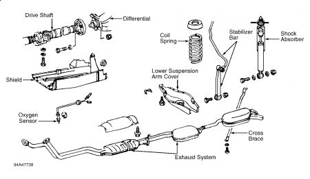

Mercedes benz has one of the most advanced suspensions known to man, Independent rear suspension has one coil spring, one shock absorber and 5 links per side. Rear axle carrier mounts to frame body and supports rear axle assembly. Some vehicles are equipped with a level control system.
https://images.2carpros.com/forum/automotive_pictures/307270_M_B_300d_1.jpg

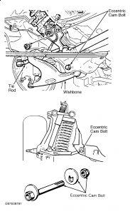

The front suspension is almost identical:
https://images.2carpros.com/forum/automotive_pictures/307270_MB300d_front_1.jpg
Mercedes Benz does not use Struts, their suspension is far more advanced and designed to give you the maximum comfort and an incredible ride. now to answer your question; to replace the rear shocks you will need to remove the entire back seat to have access to the upper shock towers, Unless they are visible from the trunk, but I doubt it, you will need two Jack's Or some Jack stands, once you have the car securely lifted, you will need one Jack to jack up and support the Lower control as you remove the shock, you will have to do the same procedure on the front, if you need further assistance let me know.
