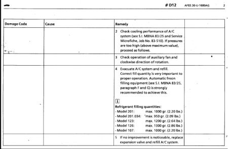

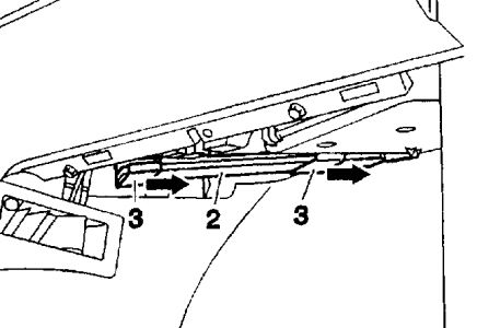

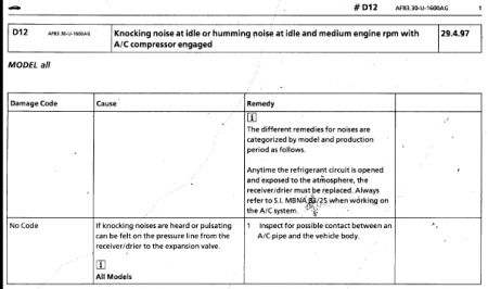

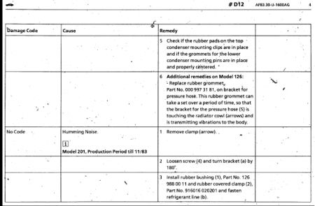

Hello - On one of the TSB, Heater Blower is Noisy; it states the air intake below the windshield is obstructed by leaves etc. There is another one, Knocking/Humming Noise at idle with A/C on.....I have attached the info on it. I would also check the cabin air filter and replace it. I have attached that for you as well. If you haven't every changed this.....you would be surprise how much debris can be in there. I would look at the air intake area and clean that out really good. Then remove the blower and clean all of that area out and then the filter and see if that makes a difference. If not then check into the other TSB. Cabin Air filter

1 Dust filter Removal and Installation : Remove cover panel below instrument panel. See: Body and Frame\Interior Moulding / Trim\Dashboard / Instrument Panel\Service and Repair Take off cover (2). Push the two remaining clips (3) in the direction of arrow for this purpose. Pull dust filter (1) down and out (arrows). Install in reverse order. Knocking/Humming Noise at Idle With A/C On All Technical Service Bulletins

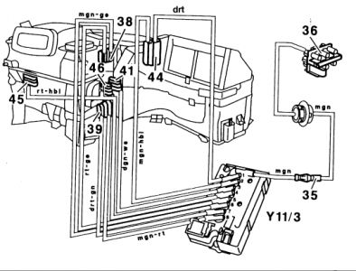

>The system filter is clean. The vent covers that supply the air for the fan are clear. There is no restriction on fan delivery.
> This noise sounds more like a vacuum leak. It does not occur continuosly. It does not occur when the climate control system is off. It does not occur when the engine is coasting (not accelerating). It occurs intermittently during most trips. But, there are trips when it does not occur at all.
> There is a vacuum line that penetrates the firewall below the coolant hoses and control module on the passenger side. Is there a vacuum module in the heater/blower area that affects some function of the climate control? If so, how do I access it?

Hello - I think this is what you are asking for. I have attached vacuum routing for the climate control. What you may be talking about is near item 35....I think this is where it comes through the firewall. I would start at 36 and work my way into the car.
https://images.2carpros.com/forum/automotive_pictures/248015_1997_MB_1.jpg
35 Cockpit separation point 36 Vacuum valve block 38 Vacuum element for defroster outlet flaps 39 Vacuum element for footwell flaps 41 Vacuum element for center nozzle diverter flap 44 Vacuum element for fresh/recirculated air flap 45 Vacuum element for left center nozzle blend flap 46 Vacuum element for right center nozzle blend flap Y11/3 Switchover valve block (8 connections) Color Code : bl = blue hbl = light blue drt = dark red ge = yellow mgn = medium green gr = gray rt = red ws = white sw = black dgn = dark green
