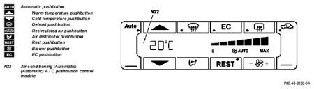

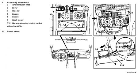

Basic Knowledge Automatic air conditioning push-button control module position/ function - GF83.40-P-2000E MODEL 202 as of 1.9.95 with CODE (581a) Air conditioning (Automatic)
https://images.2carpros.com/forum/automotive_pictures/307270_Push_button_Control_Mercedes_1.jpg
Function The control and operating module (N22) permits performance of adjustments required by the driver, such as: Passenger compartment temperature selection by pressing the warm/cold push-button, a separate adjustment for driver and passenger is not possible Manual air quantity by pressing the push-button +/- Manual air distribution by pressing the push-button Recirculated air by pressing the push-button Activation of residual engine heat recirculation, with ignition off, by pressing the push-button Switching off cooling by pressing the push-button Automatic air distribution and blower speed by pressing the push-button Defrosting function by pressing the push-button The driver will be shown these adjustments on the display. Furthermore the control module integrated into the control and operating (N22) module takes over regulation and control of systems, such as: comparison of the preselected / actual temperatures and adjustment of the passenger compartment temperature automatic switching from fresh air to recirculated air automatic air distribution automatic blower speed actuation of the refrigerant compressor actuation of the auxiliary ventilator The control and operation module (N22) can be diagnosed so that faults arising are stored in a fault memory, which can be read out On Board or with the aid of the Hand-Held Tester. You are going to have to and pull the code Removing and installing push-button control module for automatic heater or air conditioning (tempmatic) - AR83.25-P-1120E MODEL 202 up to 31.8.95 except CODE (305a) Dust filter Removal, installation 1. Remove radio AR82.60-P-7502EA 2. Pull off control knobs (1 and 2) 3. Unscrew hex. nut (4) 4. Unscrew screws (5) 5. Remove cover (3) 6. Unscrew screws (6) 7 Pull out heater push-button control module (N18) 8. Disconnect connector between heater push-button control module (N18) and blower switch (S3) 9. Remove blower switch (S3) Press catch lug (7) away with screwdriver and turn blower switch (arrow) off = left, on = right 10. . Pull out blower switch (S3) 11. Reinstall in opposite order
https://images.2carpros.com/forum/automotive_pictures/307270_removing_push_button_1.jpg
I still think it's one of the actuator doors, when you push the button can you hear a vacuum leak?
