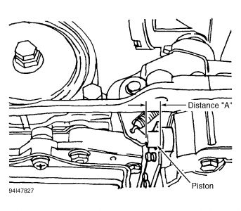

I just bought a 93 Mercedes 190e and my car will go ride in 1st and Im able to take my foot off the gas and put it back on my car will still move but when my car changes gear to 2nd 3rd or 4th gears as soon as i let off the gas I have to wait for my car to return to 1st gear in order for it to change gears again! Please help me out here, Iv never owned a Mercedes before and I dont want to mess THIS one up! Thanks for all your help and God Bless!

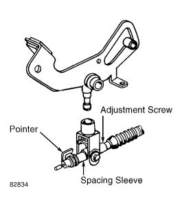

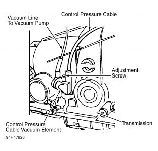

hope this help CONTROL PRESSURE CABLE VACUUM ELEMENT NOTE:Not all vehicles are equipped with a control pressure cable vacuum element. Only vehicles with dual shifting modes for transmission may have this option. Ensure control pressure cable is properly adjusted. Raise and support vehicle. Disconnect vacuum hose from control pressure cable vacuum element. Connect a vacuum supply to vacuum element. Pull control pressure cable up to full load stop. Measure how far the piston sticks out of the vacuum element (distance "A"). . Also, refer to the VACUUM ELEMENT PISTON PROTRUSION table. If vacuum element piston protrusion is not to specification, turn adjustment screw on control pressure cable vacuum element.
