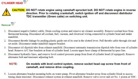

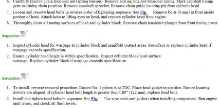

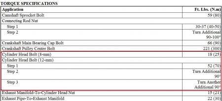

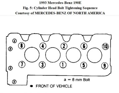

Basically just need step by step instructions on how to replace a head gasket...

Hello and thanks for donating
https://images.2carpros.com/forum/automotive_pictures/261618_Noname_2918.jpg
https://images.2carpros.com/forum/automotive_pictures/261618_Noname2_967.jpg
https://images.2carpros.com/forum/automotive_pictures/261618_Noname4_156.jpg
https://images.2carpros.com/forum/automotive_pictures/261618_Noname3_346.jpg
