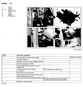

1992 Mercedes Benz 190e clutch master cylinder
STEVEL55
Transmission problem
1992 Mercedes Benz 190e 4 cyl Two Wheel Drive Manual
i have bought new clutch master cylinder,but cant get to retaining bolts to remove old one,is thier a special tool or something?
Dec 4, 2009 at 12:45 AM
RACEFAN966
  • 5,029 POSTS
Well no special tools that I can find, just need to remove a lot of stuff. Like the side air nozzle and the cover around the steering column and the light module and cover and then you should be able to get to it all. I don't know how well this will come through but here is a pic with instructions of what to do.
