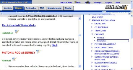

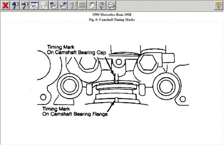

two marks in camshaft bearing flange one has a hole the other not what of the two marks is the correct one to aling with bearing cap?
