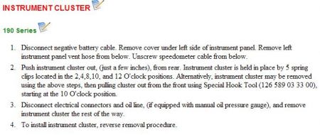

How to remove instrument cluster to replace light bulbs?

https://images.2carpros.com/forum/automotive_pictures/261618_Noname_545.jpg
