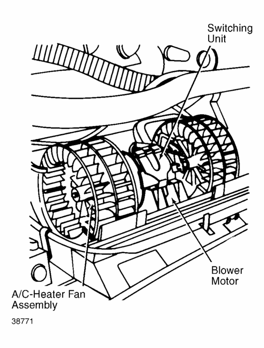

the problem i have got is that i can feel warm air coming through after a while but the blower is not working.
Can you tell me please how to get to the heater to check it and possibly replace it ,do i have to take the whole dash out?

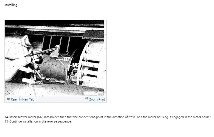

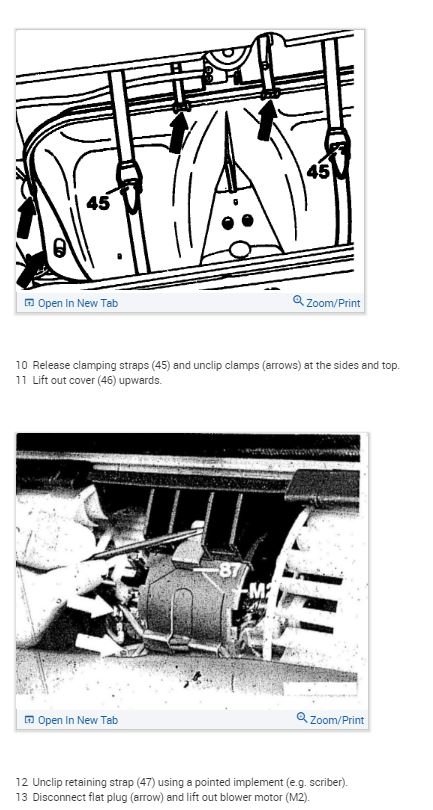

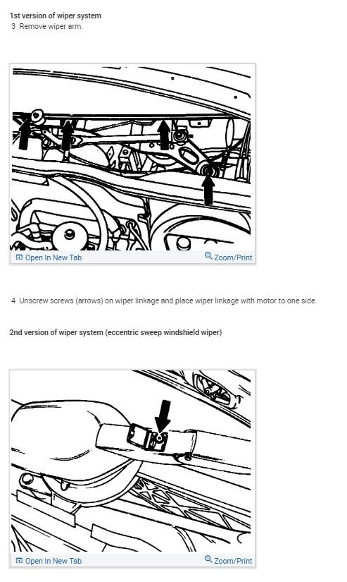

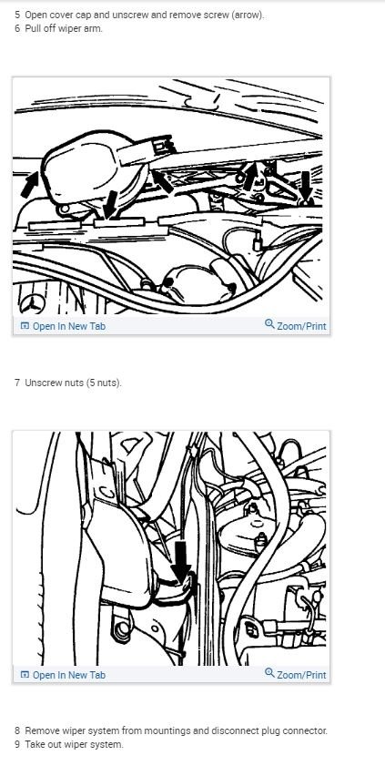

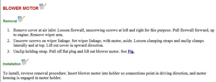

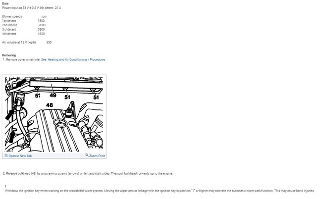

The blower motor on this vehicle is accessed from the engine compartment
Check the guide below for all causes of no air form vents before you replace the motor, could just be the resistor
https://www.2carpros.com/articles/low-or-no-air-flow-from-vents
See the diagrams below for instructions/pictures on how to replace your blower motor

to find a replacement check sites such as ebay.com, craigslist.com and car-parts.com. also call your local salvage yards. as for replacement steps, see attachments below..

https://images.2carpros.com/forum/automotive_pictures/261618_Noname_1475.jpg
