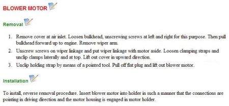

Ait con not blowing any air through vents have tried to replace fuse but not working Can't seem to find wher the blower fan situated?? For 190 e 1985 model mercedes . Cheers merry christmas !!!

https://images.2carpros.com/forum/automotive_pictures/261618_Noname_1476.jpg
