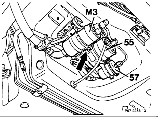

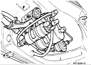

how not to break fuel filter when changing
Aug 28, 2010 at 7:27 PM
  • 75,992 POSTS
Follow the procedure below: REPLACING FUEL FILTER
https://images.2carpros.com/forum/automotive_pictures/12900_ff1_8.gif
First Version
https://images.2carpros.com/forum/automotive_pictures/12900_ff2_3.gif
Second Version
https://images.2carpros.com/forum/automotive_pictures/12900_ff3_1.gif
Third Version Remove protective cover by removing mounting bolts (arrows). On 2nd version, pull out expanding rivets.
https://images.2carpros.com/forum/automotive_pictures/12900_ff4_1.gif
First Version
https://images.2carpros.com/forum/automotive_pictures/12900_ff5_1.gif
Second Version
https://images.2carpros.com/forum/automotive_pictures/12900_ff6_1.gif
Third Version Disconnect fuel line and fuel hose. Loosen mounting screws (arrow) pivot holder down and remove filter. Install new fuel filter and plastic sleeve in flow direction. Sleeve should project on both sides of the holder since contact corrosion may occur if there is direct contact with the holder. Replace plastic sleeve, if necessary. Reinstall protective cover. https://www.2carpros.com/kpages/auto_repair_manuals_alldata.htm
