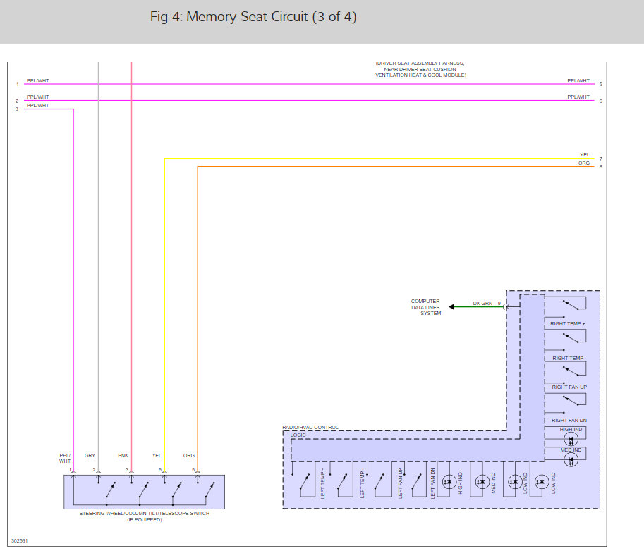

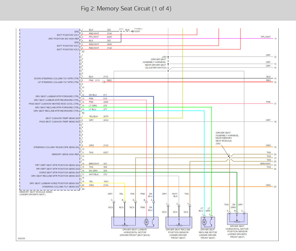

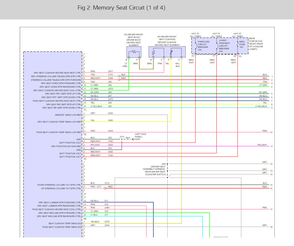

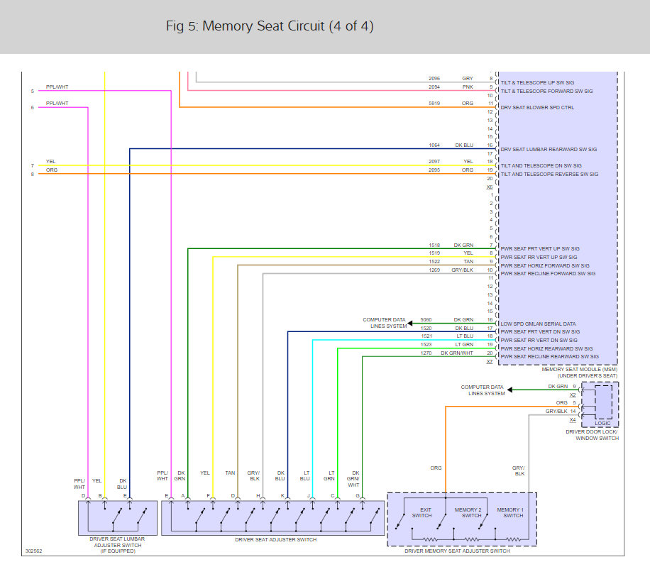

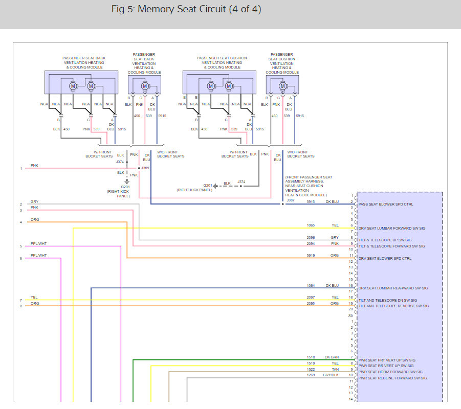

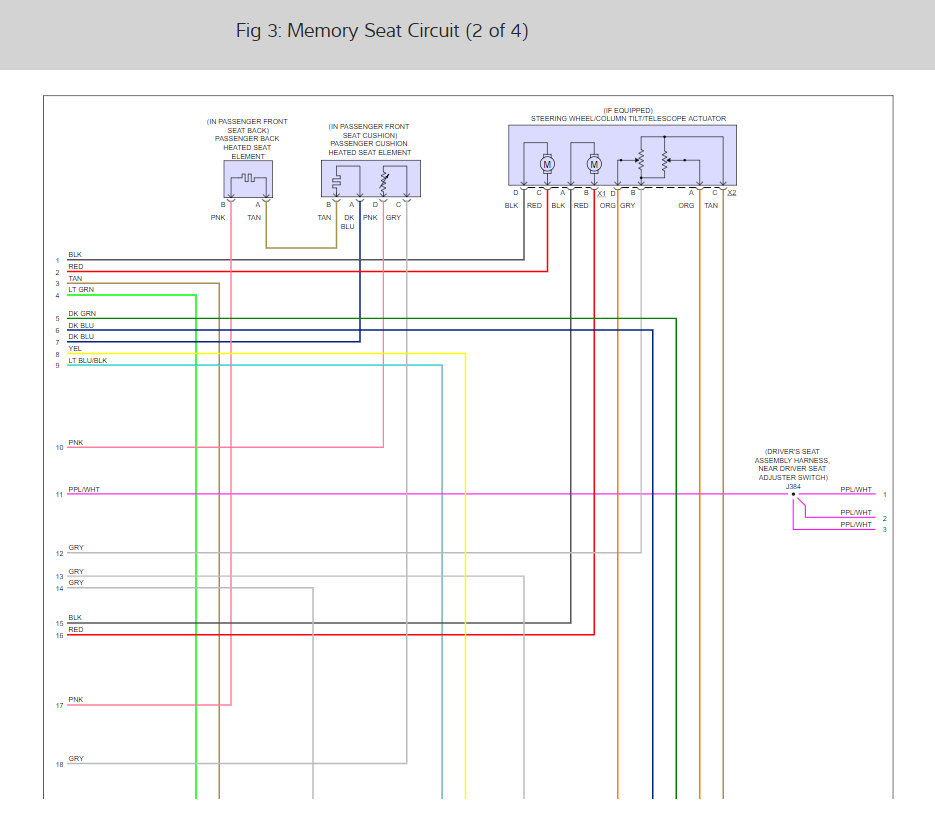

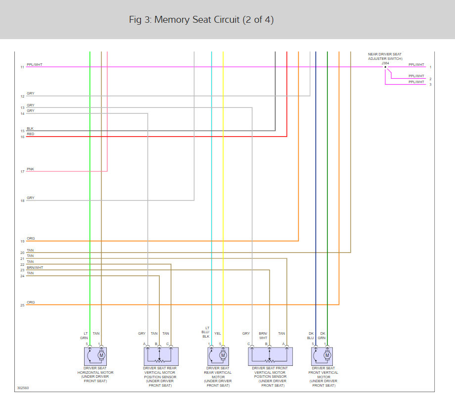

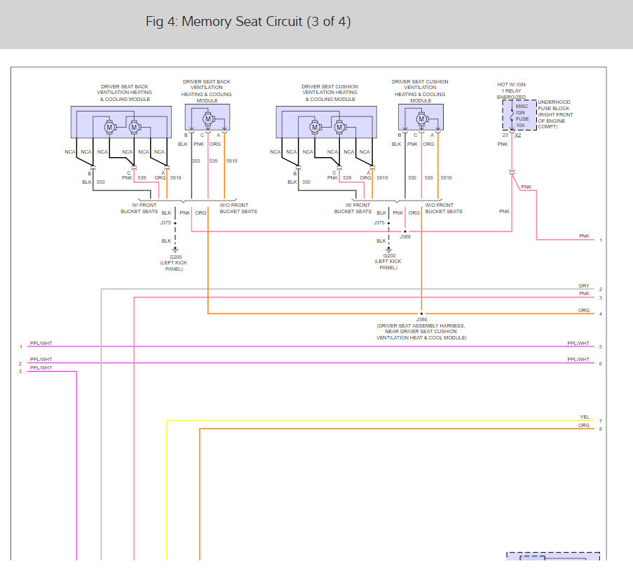

Tilt wheel only adjust down. both front heated seats turn off shortly after being turned on. memory seat function does not work.
Feb 19, 2019 at 5:40 AM
  • 55,412 POSTS

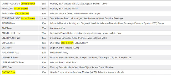

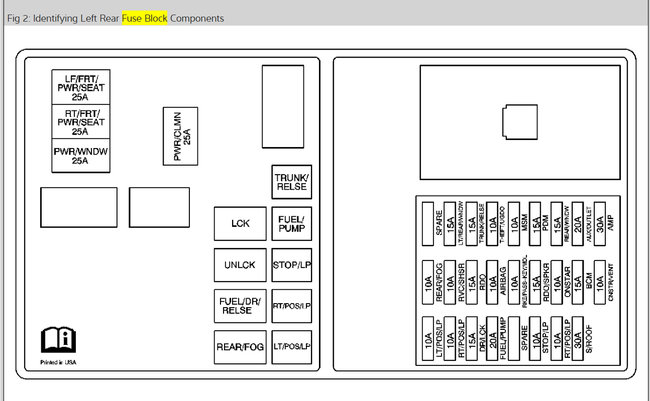

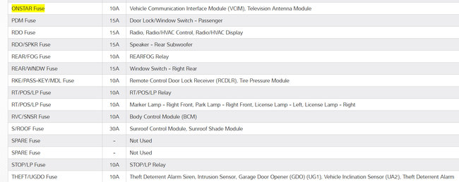

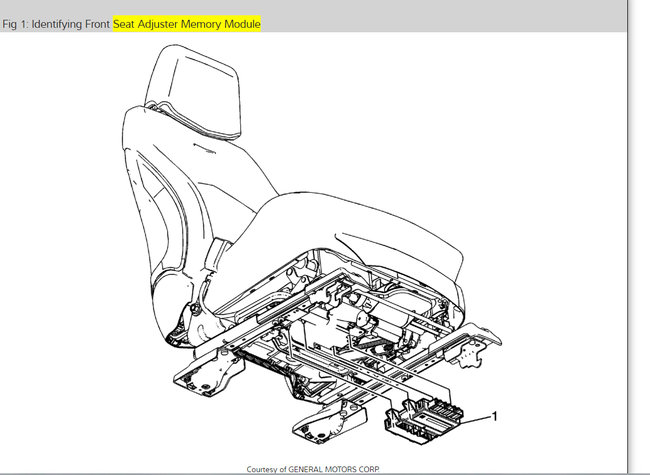

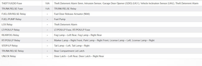

It sounds like the MSM (memory seat module) has gone out, but to be sure let's check the fuses. here is a guide to show us how to check for power and the seat heater wiring diagrams so you can see how the system works along with the fuse locations below:
If the fuse is good the MSM should be replaced. Check out the diagrams (below). Please let us know what you find. We are interested to see what it is.
