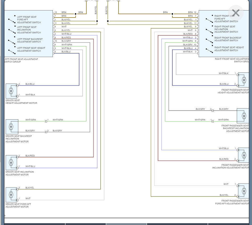

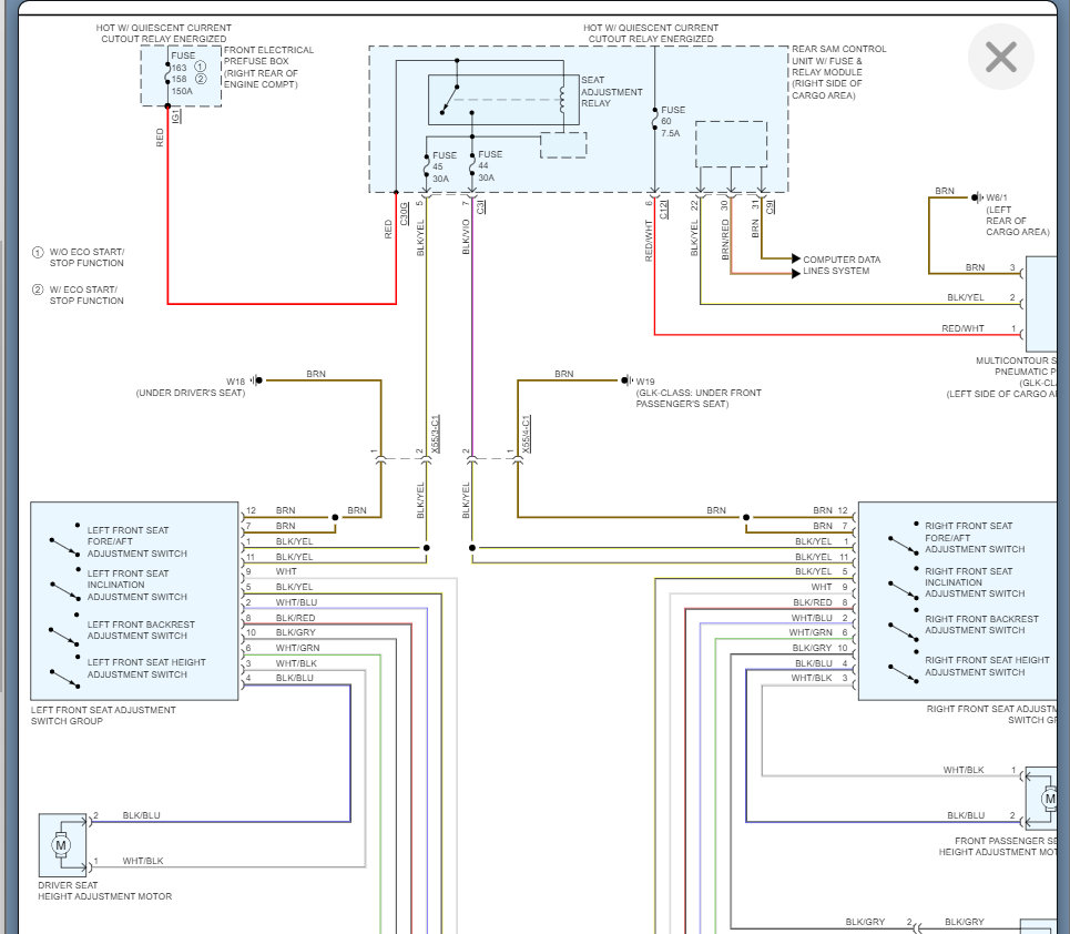

Hii , my car have power seat but ı want install memory seat full option ( ı bought front memory seat and switch and wood decor )
I need to 2015 memory seat electric diagram

Unfortunately, it appears we do not have the exact diagram that you are looking for. We don't have the C200 but only the C250 and it appears that it does not have a memory seat option.
So, we are attaching the diagram that is the closest match to what you may have.
I am also attaching a couple guides that may help others that view this page with slightly different issues.
https://www.2carpros.com/articles/seat-position-switch-replacement
Sorry for not having exactly what you are after but unfortunately, we are at the mercy of the online manuals that we have. Thanks
