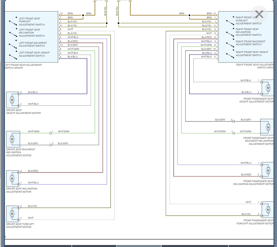

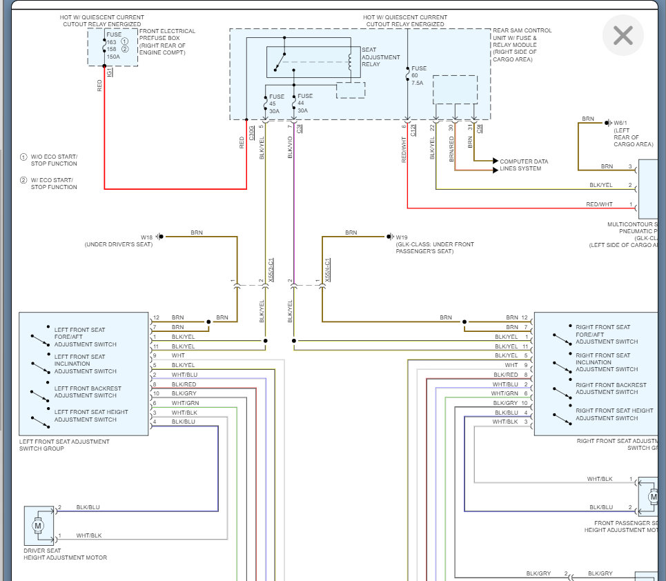

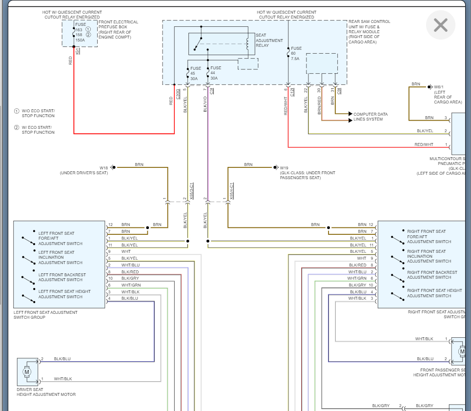

Hii , my car have power seat but ı want install memory seat full option ( ı bought front memory seat and switch and wood decor )
I need to 2015 memory seat electric diagram
Jun 4, 2022 at 7:44 PM
Unfortunately, it appears we do not have the exact diagram that you are looking for. We don't have the C200 but only the C250 and it appears that it does not have a memory seat option.
So, we are attaching the diagram that is the closest match to what you may have.
I am also attaching a couple guides that may help others that view this page with slightly different issues.
https://www.2carpros.com/articles/seat-position-switch-replacement
Sorry for not having exactly what you are after but unfortunately, we are at the mercy of the online manuals that we have. Thanks
