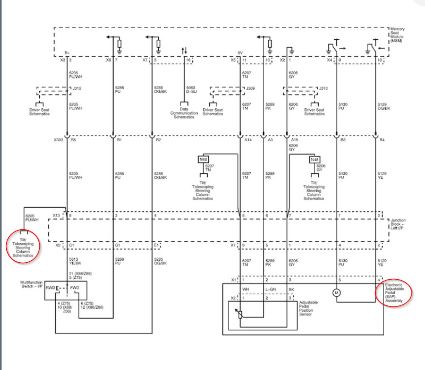

The electric tilt wheel and pedal adjustment quit working
2013 CADILLAC ESCALADE
75,000 MILES • 6.2L • V8 • 2WD • AUTOMATIC
BRADENRACING23
Is this likely the power control module PN 20870473?
Nov 24, 2019 at 9:41 AM

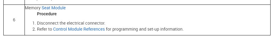

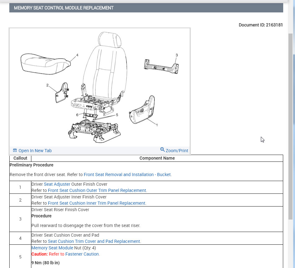

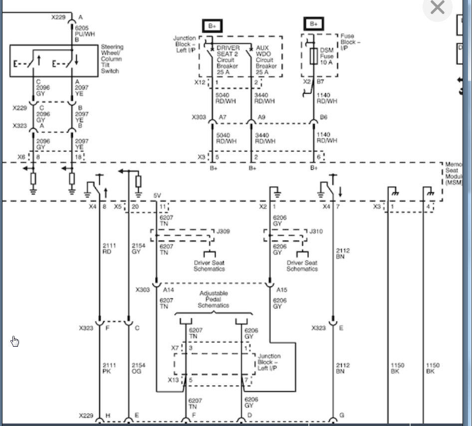

I would assume that the memory seat module is the issue. According both wiring diagrams the MSM controls both functions. So I would probably go ahead and replace this unless you want to check voltage coming out of the MSM to each function.
Let me know what happens but I would be surprised if this is not the issue.
Nov 24, 2019 at 10:58 AM
BRADENRACING23

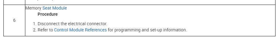

Replacing the module fixed the issue. I did have to get it programmed after install.
Jan 26, 2020 at 11:43 PM
Great news. Thanks for the update. I am sure that info will help others. Also the fact that it requires programming. That is great information. Thanks and come back to 2CarPros in the future if you need assistance.
