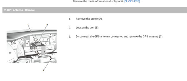

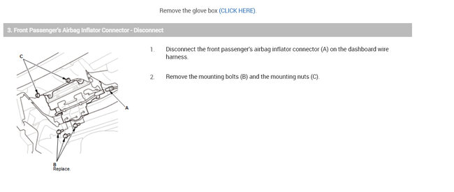

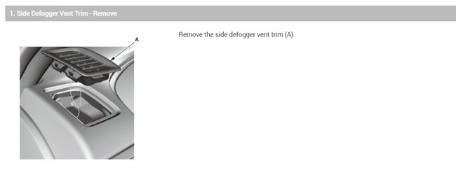

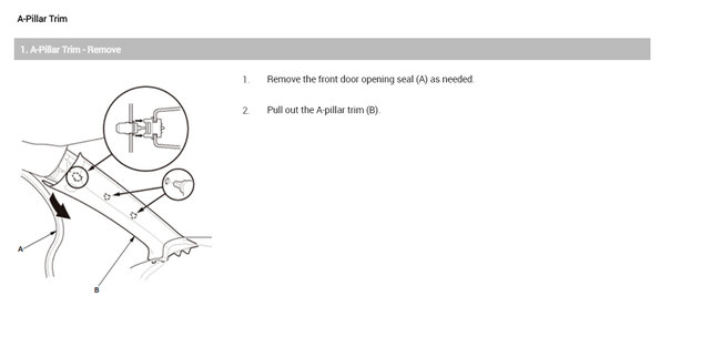

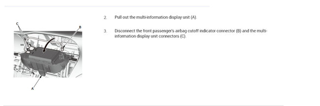

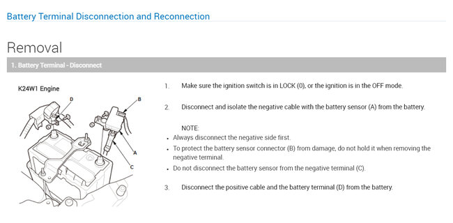

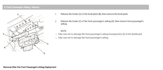

It depends how bad the damage was, can you upload an image so I can see. If it can't be fixed. here is how to change out the piece to fix the problem. Check out the images (below). Let us know what happens and please upload pictures or videos of the problem so we can see what's going on.
