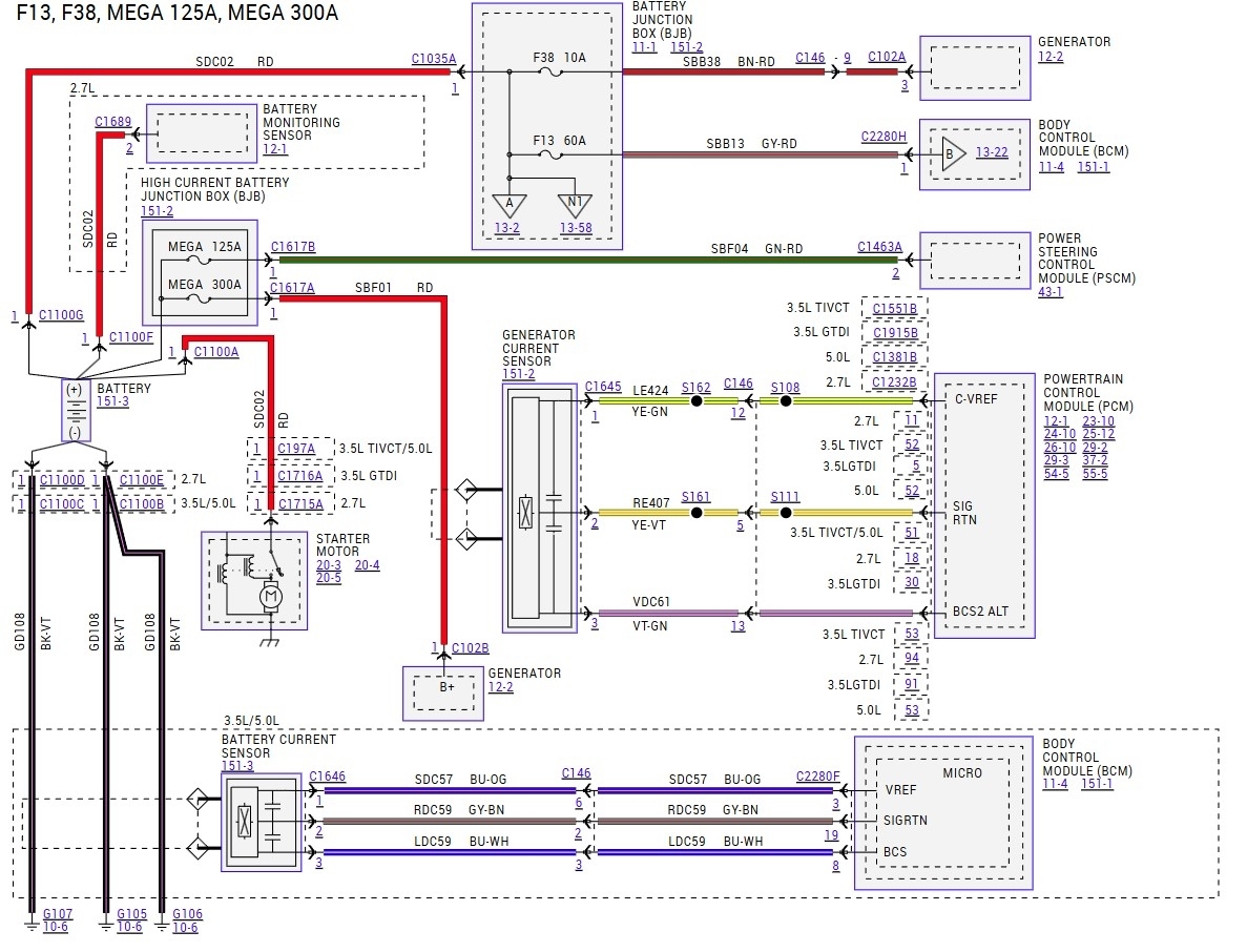

Greetings!
I am searching for an image, a diagram, or even just an explanation as to what goes to the Megabus attached to the fusebox. I understand the positive battery terminal consists of the starter red wire, and then the other large red wire comes from the Megabus to the alternator, the green wire goes to the BCM,but now I have an open spot on the Megabus, and only a ground wire without a place to go. The Megabus appears to have a grounding spot, but upon further inspection, that spot attaches to the other Megabus locations, which doesn't make sense to attach a ground in this same location.
If I had an image of the correct wiring of the Megabus, and the battery terminals with a brief description of what goes where, I'd be in good shape. I've attempted to guess previously, but unfortunately, there is no power at all. Any suggestions as to what I may need to check would be very helpful. I've checked the appropriate fuses and will be replacing most of them, as well the relays tomorrow, just in case.
Thank you in advance for any assistance you can provide. I greatly appreciate it!

There is no ground wire near the fuses. The Mega fuse is the main power fuses for the entire truck. Connect a ground to it and if you are lucky it will only burn up the wire.
The Green goes to the electric power steering not the PCM. What color is the "ground" wire.

Okay, so what connects to the mega bus? It's not the starter. The starter connects straight to the battery. So that leaves the 300a, which the alternator, the the green, which leads to the power steering, and then what goes to the last spot? I have no other components that I can find that need to be connected and no other wires needing to be connected, with the exception of the ground wire, which I believe goes to the transmission ground location and attaches to the negative battery terminal.

My apologies. I just saw the diagram you sent. That is precisely what I've been looking for. Thank you, very much!

No problem. If both the power steering and alternator are on the 300, they shouldn't be. The steering goes on the 125 with the alternator on the 300. The 300 is actually there to protect the battery and vehicle systems in the event something in the alt fails. Plus the alt is rated at 215 amps so not a lot of overhead if there is a problem.
No problem not seeing the image. As I said though, there are no grounds to the BUS fuses. Normally there will be 2 larger grounds, One goes to the engine another to the frame, then a third that connects the body and frame. Perhaps your ground is one of those or maybe not used.
