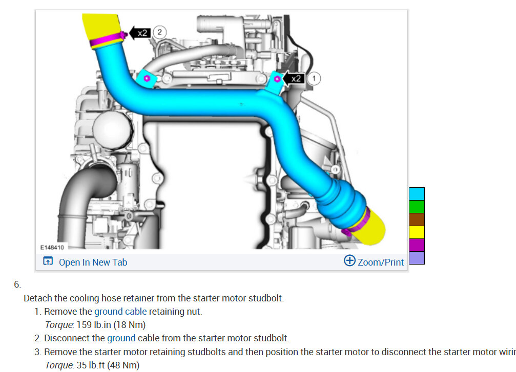

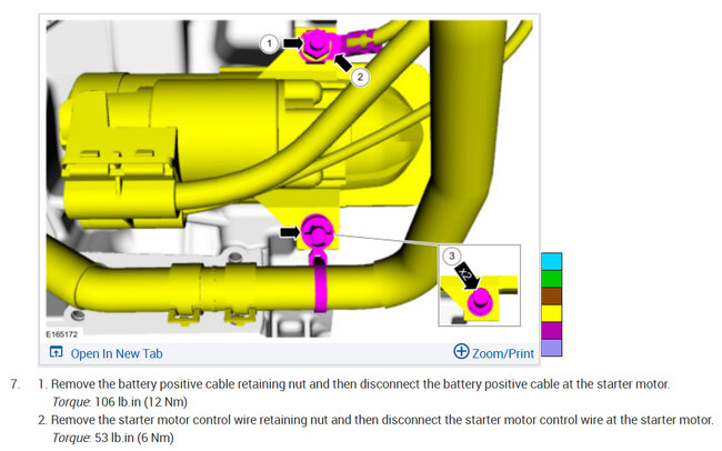

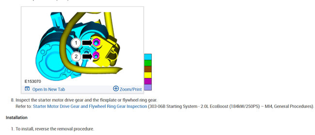

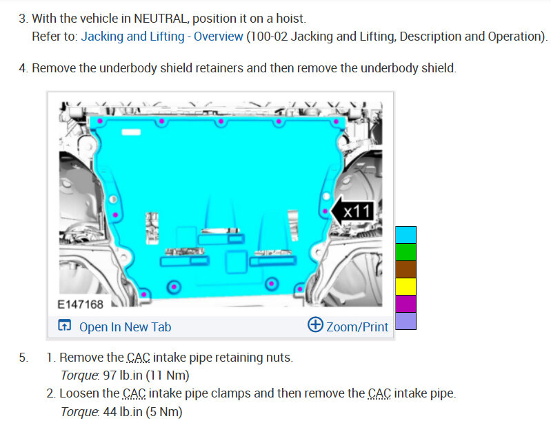

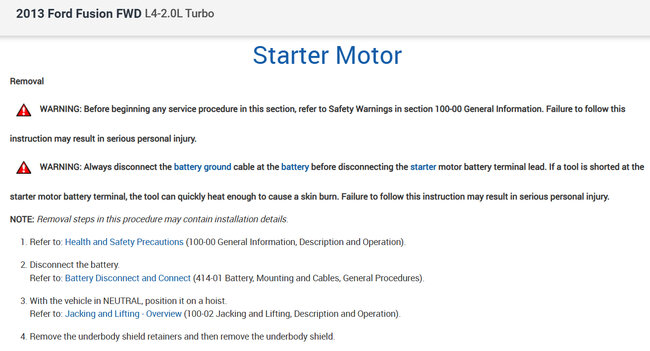

The book only gets 1.2 hours to change the starter out, so I am not sure what the problem is there. Here is how the job is done so you can see what needs to be done. Check out the images (below). Let us know how it goes.
