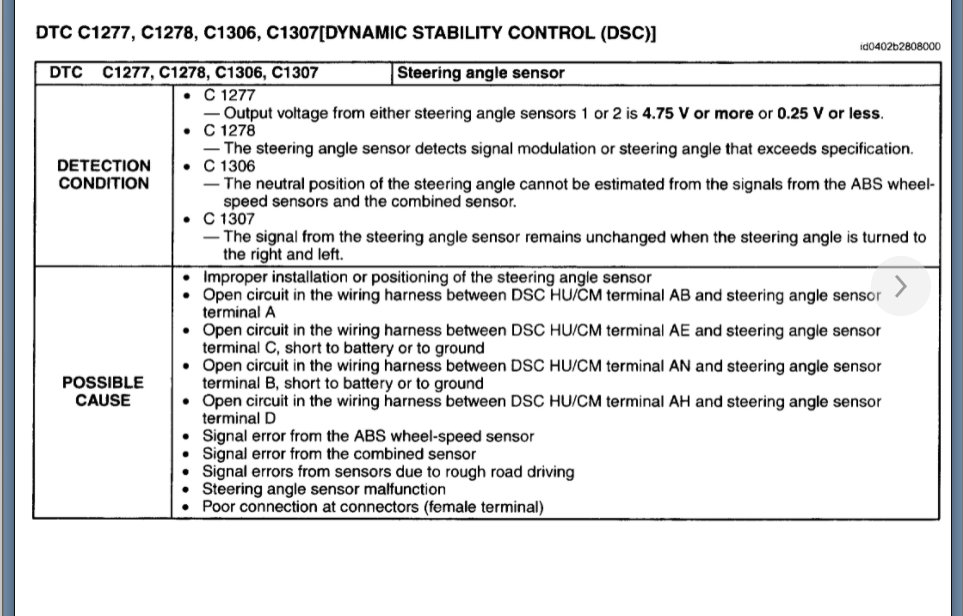

Finally got codes on the car. There is a C1277 code, bad steering angle sensor. It is a little unclear whether replacing the sensor would fix the problem with the power steering.
I am using FORScan for obtaining the codes, there is no response on the EPS system in FORScan.
I am fine replacing the sensor, and have a spare electric pump assembly, but not sure how best to proceed.

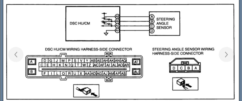

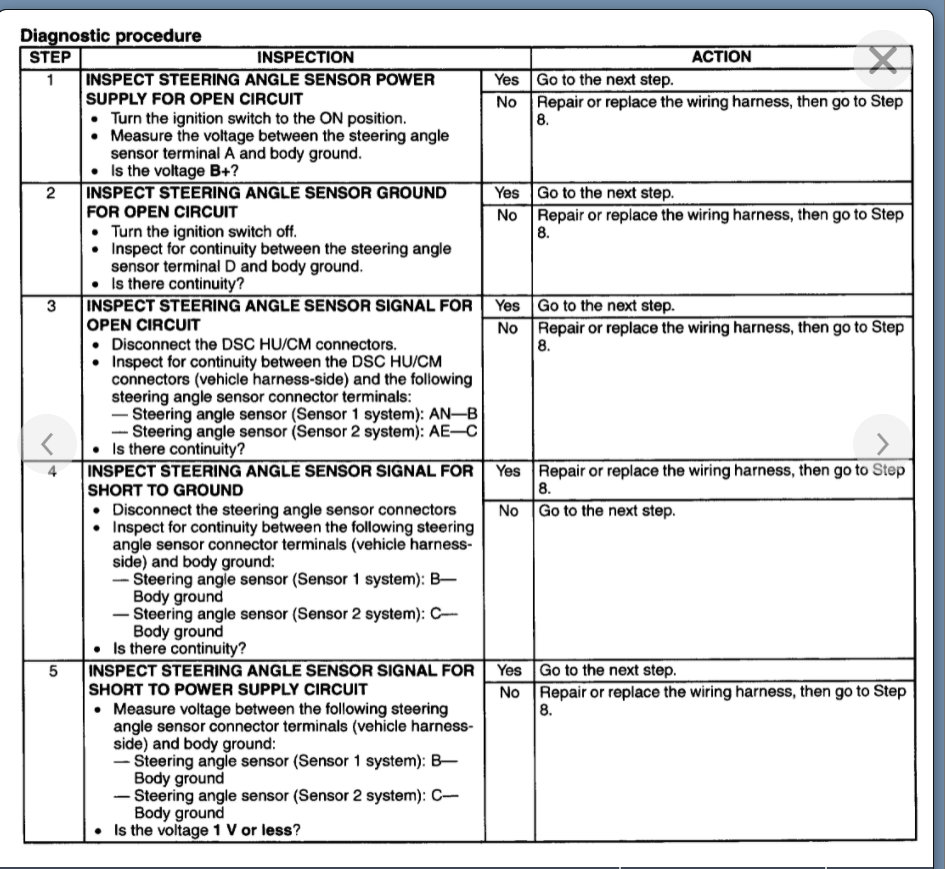

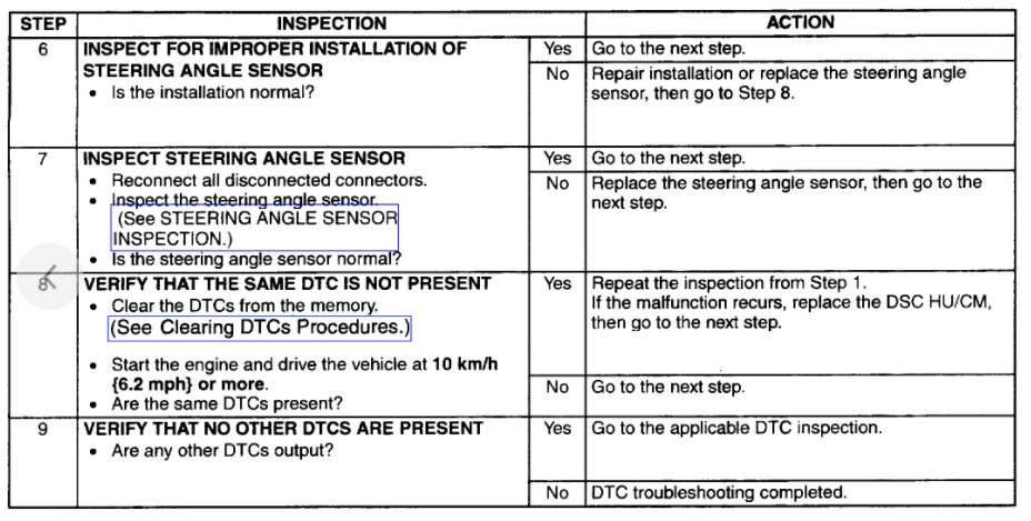

I think you are touching on all the issues. The code is not likely to cause the power steering to work because you have a mechanical system and is not electronic.
So, we should address this code which I am attaching the info below.
Here is a guide that will help with this type of testing:
