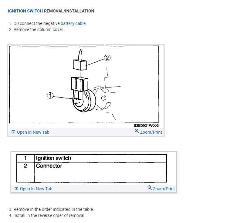

Hello, I am changing the ignition switch as it is very worn and would like to know if I have to reprogram anything.
Nov 8, 2019 at 4:33 PM
I attached the procedure for the ignition switch and there is no programming mentioned. I am not sure if this is definitive enough but if all you are doing is the switch then there is not any programming required.
