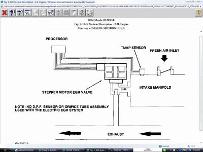

I have an 04 B2300 automatic with 42000 miles. It pings when at highway speeds. I was told that it may be the egr valve. I bought a replacement however I cant seem to find its location. Please help.
Thanks

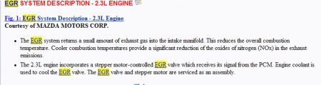

I doubt it's the EGR unless the MIL is on! You didn't say what engine this is the 4 cyl...
https://images.2carpros.com/forum/automotive_pictures/62217_EGR2300details_copy_1.jpg
https://images.2carpros.com/forum/automotive_pictures/62217_EGR2300_1.jpg
