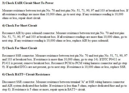

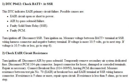

hi i have amazda b2300 1996 4cyl. 5spee engine 2.3 the scanner was put on the truck the result was PO412 that was the code that ithe SCANNER IDENTYFIE prolem the cuestion is can you tell me what part i need to replace whe the scanner gave me this code ?

P0412 Secondary Air Injection System Switching Valve A Circuit Malfunction
https://images.2carpros.com/forum/automotive_pictures/261618_Noname_271.jpg
https://images.2carpros.com/forum/automotive_pictures/261618_Noname2_83.jpg
