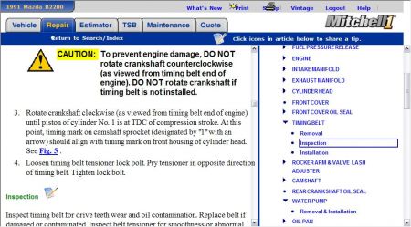

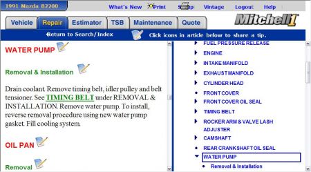

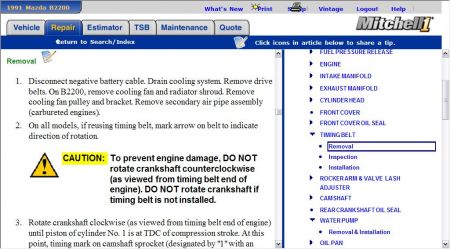

Can you send me instructions on how to change out the water pump on my 1991 mazda B2200 pickup truck?
Tuesday, December 25th, 2007 AT 8:30 PM
MECHANIC
75,992 POSTS
See below for water pump and timing belt
