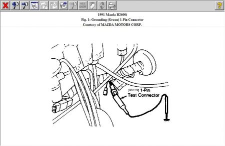

Starts, runs fine for a few miles, then dies, but restarts, check engine light comes on, runs rough
after that. This has been consistent with the last 10, or so times I've set out. Also is there a way to retrieve the codes with out buying the obd 1 scanner?

Using a jumper wire ground Green 1-pin connector located above right side front wheelwell-see illustration below
https://images.2carpros.com/forum/automotive_pictures/12900_Green_1_pin_connector_1.jpg
