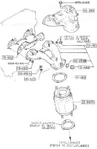

I almost grabbed the on-line manual for a week to see if they could give me the step-by-step in replacing the front Catalytic Converter on this model truck. I took this engine out so I should remember how the front Catalytic Converter is removed but I don"t because of the time that has passed since that event. Does the mitchell online manual have what I want for the mazda b2000 1987 truck when it comes to removing the front Catalytic Converter?

Yeah, all that AND how to get to it. Can I get it off from underneath the car?
Or do I have to drill down from the top by removing the exhaust manifold first?
Is the repair manual in question going to have this info?

no it wont tell you how to get to it or which way they go in.
they are very vague on exhaust system installation.
you can get at it from the bottom.
easiest if you have a lift or if you can block the vehicle up!
i have yet to see a online or book manual that has exhaust system information about installation.

Got the starter from the dealer but they are only selling REBUILTS by their guys in California. It's overall length is less than the one I'm replacing so it was easier to get in...And then I asked the guy at the Parts Counter about the front cat and asked for a picture of the installation if he had one. He did and I include that here for everybody to contemplate. Then I asked the price for the cat. $1037. Yeah, that's right! Over a $1000 for Fed or Cal. The Fed was a couple of bucks cheaper. And $38 for the two gaskets! I'm off to the junkyard to see if the cross reference can be to later model...one that was running with a good computer so the cat is still got some function left. Otherwise, I'm thinking two cats in series before the muffler ought to have the same effect.
https://images.2carpros.com/forum/automotive_pictures/181000_mazda_front_cat3_1.jpg
