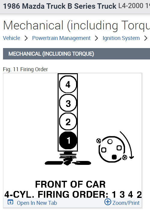

when timing marks are all lined up and cylinder 1 is TDC, which direction should the rotor in the distributor be facing?
Mar 31, 2007 at 8:06 AM
  • 75,988 POSTS
Should be rotating clockwise and the no.1 tower @ 12 o clock looking at it at the drivers side-
Firing order-1342 ( clockwise) rotation

Make sure you are on the compression stroke, turn the engine by bumping the starter and remove #1 spark plug, when you feel pressure as the timing mark is coming up you are on the compression stroke, the mark will come up twice but only one of them is the compression stroke.

With the timing marks aligned and cylinder 1 on the compression stroke, point the distributor rotor at the No. 1 tower at 12 o'clock as viewed from the driver's side. Distributor rotation and firing order 1-3-4-2 are clockwise. Confirm compression by feeling pressure at the removed No. 1 spark plug as the timing mark approaches, then set and adjust ignition timing.
