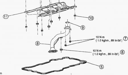

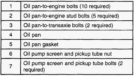

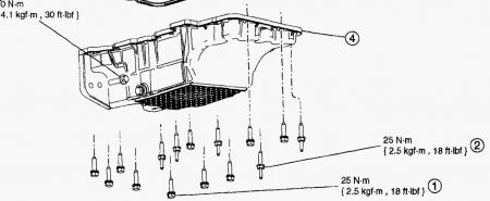

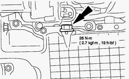

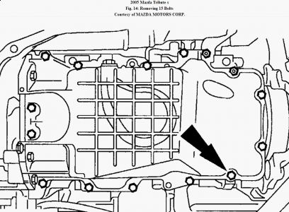

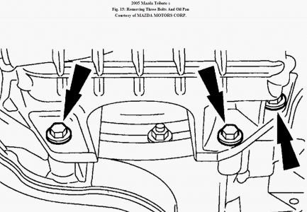

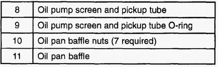

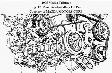

Is it possible to remove the oil pan
Feb 6, 2010 at 8:52 AM
MERLIN2021
  • 17,250 POSTS
Yes, here's how. Fig. 12: Removing/Installing Oil Pan & Torque Specifications Courtesy of MAZDA MOTORS CORP. REMOVAL 1. Remove the flexible exhaust pipe. See EXHAUST FLEXIBLE PIPE -- 3.0L (4V) . 2. Drain the engine oil. Fig. 13: Removing Bolts And Drain Engine Oil & Torque Specifications Courtesy of MAZDA MOTORS CORP. 3. Remove and discard the oil filter. 4. Remove the 15 bolts. Fig. 14: Removing 15 Bolts Courtesy of MAZDA MOTORS CORP. 5. Remove the three bolts and the oil pan. Fig. 15: Removing Three Bolts And Oil Pan Courtesy of MAZDA MOTORS CORP.
