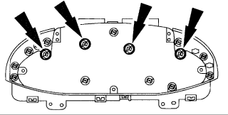

The gear and odometer display does not light up as it used to, making it difficult to see what gear you've shifted into during night-time driving. Could this be a simple fix like replacing a blown bulb? Would this cause the car to fail my annual Pa. state inspection?
Your help would certainly be appreciated.

Hello I have attached information on changing the bulbs. Hope this helps. Warning Indicator Bulbs Removal and Installation Remove the instrument cluster; refer to INSTRUMENT CLUSTER.
https://images.2carpros.com/forum/automotive_pictures/248015_1_7.gif
Remove the desired miniature bulb by turning it a quarter turn counterclockwise and lifting straight up. To install, reverse the removal procedure. Select Indicator Bulbs Removal and Installation Remove the instrument cluster. For additional information, refer to INSTRUMENT CLUSTER.

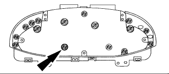

Remove the selector lever indicator bulb. To install, reverse the removal procedure. Insturment Cluster Bulbs Removal and Installation Remove the instrument cluster. For additional information, refer to INSTRUMENT CLUSTER.
https://images.2carpros.com/forum/automotive_pictures/248015_3_9.gif
Remove the instrument cluster bulbs. To install, reverse the removal procedure
