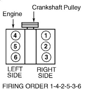

Where are the engine coils/spark plugs in a 2002 mazda tribute lx?

Each plug has it's own coil, it's called oddly enough coil on plug. look for the black things with the wier connector plugged into each one, remove the connector, remove the hold down screw pull up on coil, plug is under the coil. These are mounted on valve cover, over each cylinder.
