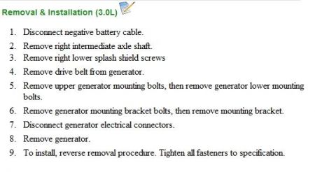

What is the procedure for changeing the alternator on this vehicle?

https://images.2carpros.com/forum/automotive_pictures/261618_Noname_2370.jpg
