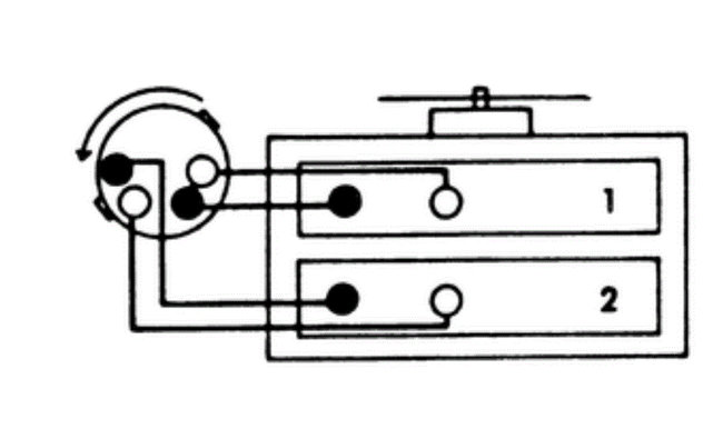

1999 Mazda Rx7(79,000) non-turbo. I'm not sure which wire goes to which terminal? The previous owner bought new wires, didn't mark them and , mixed them up.

The vehicle should have the 1.3L 13B Wankle rotary engine. If that is correct, there will be indicators on the distributor cap. They should be as follow:
L1
T1
L2
T2
If you look at the pic attached, it shows the rotation of the distributor rotor, where each wire goes on the distributor cap, and where each of the wires go to the spark plugs. Note the connection in black are the T connectors, and the white connections are the L connectors.
See pic below.
