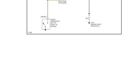

Hi
Am having a bit of a problem regarding my electric fan.
Sometimes the fan stops to work recently for some unknown reason, thus my water temp goes up.
The fan usually kicks in automatically around 89 degrees.
When the fan stops working i had to pull over, switch the engine off, pop the hood up & play about with the fuse, eventually it'll come back on.
I notice when am trying to get the fan back on via playing about with the fuse, i can hear the relay clicking.
I have changed the fuse & relay thinking it should solve the problem but no. It still occurs.
Any ideas?
Regards Alex

Hi JunT86, Welcome to 2carpros and TY for the donation Inspect and test the water temperature switch on top front of engine and ground point G107 behind right headlight
https://images.2carpros.com/forum/automotive_pictures/12900_f1_18.jpg
https://images.2carpros.com/forum/automotive_pictures/12900_f2_18.jpg
https://images.2carpros.com/forum/automotive_pictures/12900_f3_9.jpg

I can really see the description on the images, kinda small. Can you post a bigger version?
Oh forgot to note that its been modified & and fitted with Defi gauge Water Temp and checked the sensors are fine.
